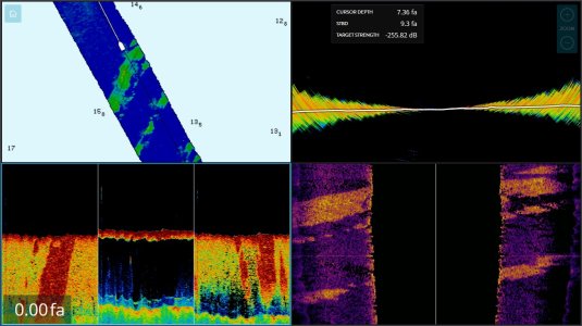

Do you know what the advantages are for side scan that is used with WASSP F3. If the scan width or reach is the same. What would the side scan show that would be different than the regular beams of WASSP?
Thanks snips for your help.
I use the side scan view to reconfirm bottom hardness.
