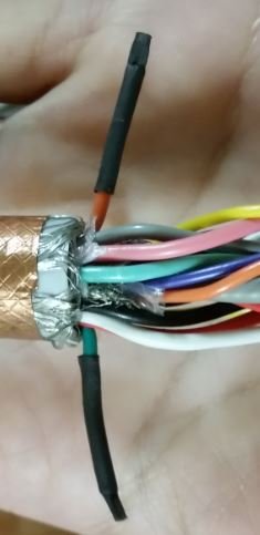

Good morning MickyD,
Thank you for the additional details. After further review you may be able to use the existing radar cable but it will take some modifications to the cable to make it work. As I mentioned in the previous post the open array requires an additional 2 wires that will terminate on J822 in the open array. If you look at the cable that is currently installed on your vessel those two wires cannot be seen. You will need to remove some of the heat-shrink of the cable to expose two additional wires, Orange and Green. Those two wires have been trimmed back and also heat-shrinked because they are not needed with a radome installation. However, if you pull back the heat-shrink you should find the two wires. You will need to lengthen those wires and re-terminate into a 2pin NH connector. Once that is done you can plug into J822.
The Green wire will go to PIn 1 on J822 and the Orange wire will go to Pin 2 on J822.
If you need help sourcing the 2 Pin NH connector please give our tech support line a call and they will be able to find you the part number. The part can be ordered from an Authorized Furuno Dealer.
