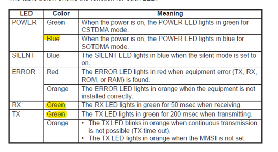

The table below shows the normal indications: Power - BLUE continuous******* Silent - Extinguished********Error - Extinguished*******RX - Green when receiving other vessel transmissions*************TX Green when transmitting (the rate depends on the vessel speed, every 30 seconds to 3 minutes) The TX light will be off most of the time when sitting still.

I have been in a marina since I installed the FA-70. If it does not transmit the location since I haven't moved, it would explain my situation as I see no green or orange TX light. I have not looked at the TX light from power ON. I assumed that the AIS would resend the position every few seconds regardless if it changed.
The receiving AIS stations must require new data to refresh their information. How often is new/refresh AIS data required or transmitted?
