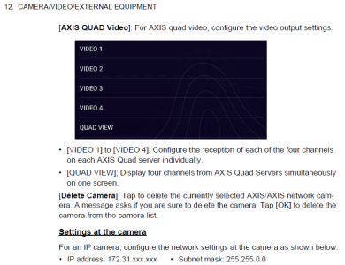

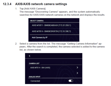

Trying to configure my BB to connect to an Axis Quad server and running into a road block. First thing is when adding a camera there is no selection to add a server, just an individual camera. Either way it's unable to find the camera. I've tried switching the BB wifi off to maybe force it to look at the connected switch.
IP Address for the server is the one found in the old TZT2 document.
Any ideas?

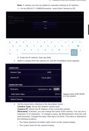

Did you try manually entering the Axis Server IP address? If you click "Add Axis Camera", if it times out looking for the camera it will display a screen that you can "add camera by IP". Try entering the IP and see if it displays video.
