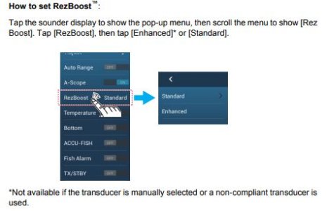

I would be interested in seeing a screen shot or two of both frequencies while you are running. As far as Rez Boost not appearing. I just tried mine and even without a transducer connected the Rez Boost selection will still appear, but only Standard is available not Enhanced. I have SW version 5.03.

I checked my system for the resboost and the control is not a part of my soft ware. I called tech support and I need to down load and re-load the soft ware. I have to tear the dash apart to get to the sd card holder. I will install the event switch at the same time.

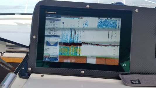

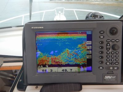

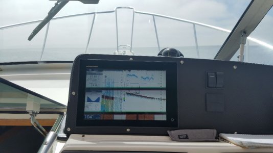

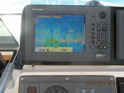

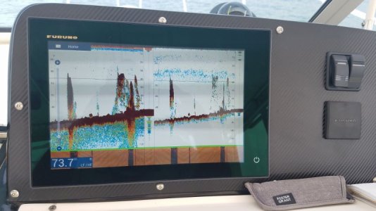

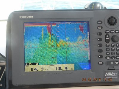

NN1 low freq 1 (1024x768) (800x600).jpgI took the boat out and did some testing at slow, 7.5 kts and at 14 to 22 kts.
The slow speed performance is acceptable and better than the old system, (NN1 with DFF1) with same transducer(B260).
The old system had clutter, TVG, chart speed, gain, A scope and a few other adjustments and I was able to tune the performance so that I could read through high speed clutter and pick up off shore bait and Tuna marks. All adjusting in manual mode using dual frequency.
The TZT2 has many more adjustments. I turned off A Scope and auto depth. These made the machine lose the bottom in 120 feet going faster than 14 kts. I tried various TVG and clutter settings to get an acceptable screen view above 14 kts. Nothing seemed to work. I left my notes at the boat.
There are adjustments for LF and HF gain off set. not sure what that does, I tried different settings, no help.

Looks like there is a file limit.
The NN1 Dual Freq BFT was an off shore Bluefin Tuna school. Running speed at 7 kts.
TZT2 14.9 kts. Starting to lose LF.
TZT2 10 kts. Reading is still good in shallow water. California has deep water. We fish in shore from 25 to 100 feet during summer or up to 360 feet for rock fish in winter.
The summer season, I set the sounder to 200 to 300 feet and mark bait and tuna schools. This is the setting I need the most help with.
The auto fishing mode is fine for shallow water.

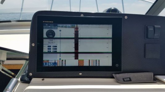

The TZT2 16.9 kts picture has the bottom scale freaking out form 50 to 1200feet. The auto depth was off. I then turned off A scope.
I ran in 120 feet at 22 kts and tried Auto Fishing mode. It kinda work with a low thin bottom.

Tunacious Too,
Thanks for the screen shots. However when I enlarge them to see the detail better they are to fuzzy. From what I can see I would first turn off the Bottom Discrimination mode. The BD mode changes the TX Rate and pulse length. Also the Bottom Level setting should be at -20 for both LF and HF channels on the TZT2.

Tunacious Too,
All your TZT2 screen shots showed the BD Mode was on.
The LF/HF main gain controls go from 0-100. In reality the sounder never really has "0" gain as there is always on the display. The Gain Offsets in the menu are used to set the "0" point. If you want to see how they work set the main gain at 20 and adjust one of the Offsets, you will see it will be almost be the same as adjusting the main control. Normally these Offsets are left at the default setting of 0.
