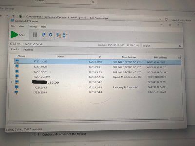

When the TZT24X is powered on, it assigns IP addresses to all devices on the network. I verified this using Advanced IP Scanner on a laptop connected to the same Furuno Hub102 as the other devices (see IMG_4988.JPG). Both the Seakeeper and Lumishore units receive IP addresses correctly and are visible on the network.

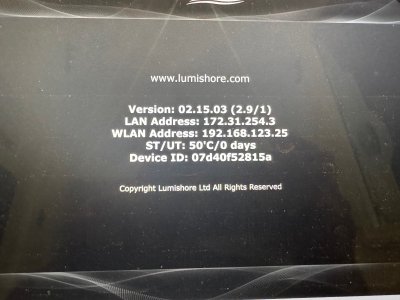

Additionally, I can successfully access the web interfaces of both Seakeeper and Lumishore through a browser on the same laptop (see IMG_4976.jpg and IMG_4990.jpg). However, the corresponding pages are not appearing on the TZT24X.

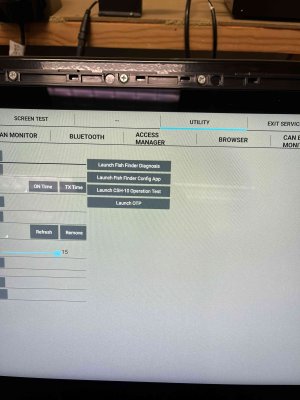

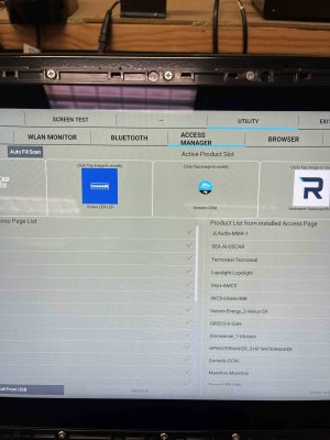

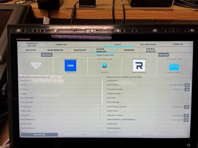

On the TZT24X please go to SETTINGS -> INITIAL SETUP -> SERVICE. In SERVICE select UTILITY -> ACCESS MANAGER -> If the product is not occupying one of the 5 slots do an AUTO FILL SCAN. If that doesn't work manually add them by "Click/tap here to set"

Thanks for the detailed steps. Quick update — installing firmware 25.21 resolved everything. For Seakeeper the upgrade wasn’t actually necessary, but for Lumishore it was absolutely required. After the update, the unit recognized the product right away.
