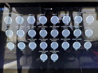

I’m currently troubleshooting an issue with my Furuno TZT24X MFD running firmware 25.21. The unit is not retaining or displaying the CZone pages after a reboot or after powering the system off and back on.
Here’s what I’m seeing:

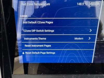

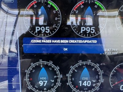

  • If I go into the settings and add the default CZone pages, everything appears normal and fully functional.
  • However, after a power cycle, the CZone pages disappear from the main interface.
  • Interestingly, if I swipe out the right-side menu, I can still see CZone listed at the bottom, but the main pages themselves are gone.
