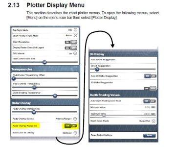

Hello, We have a system with two TZ Touch displays. When you zoom in on one display, the other zooms as well. This is causing issues with the owner. It seems to do it in the chart screen as well as the radar. Both units are latest software. Any ideas how to stop this?

I would first make sure to check and see if you have the "Radar Range Link" activated on both screens. You can find the "Radar Range Link" under [Menu] [Plotter]. It will link the plotter and radar screens to the same scale so you do not get an over-scaled or blurry radar when using the overlay.
