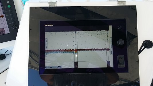

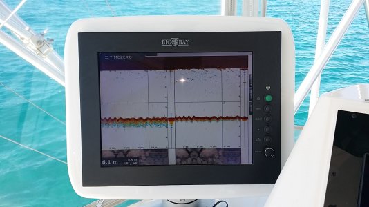

The other issue is different and relates to the bottom discrimination. I have attached 2 pictures which show the problem. One is using the TZT14 and the other with Nobeltec TZT. The bottom discrimination is correctly represented in the Nobeltec while it is not working right on the TZT. Any suggestions? Forgot to mention that the software update on the TZT is that the latest done a couple of months ago.

Rmenendez,
Thank you for your screen shots. It looks like the UHD is displaying the bottom classification but only in the A-Scope window, not the sounder history. Does this happen all the time or only in shallow water?
Hi Snips,
This happened last Monday all the time - from about 50M depth to the 6M where I took the photos. I decided to try seeing if I was getting the same problem with Nobeltec to compare which was strange. Do you have some thoughts about the transducer problem?
