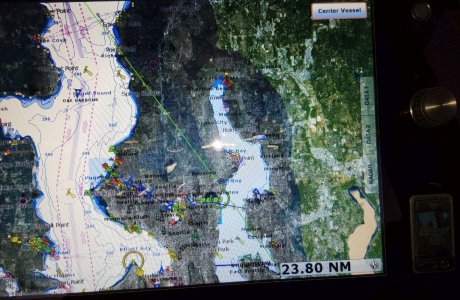

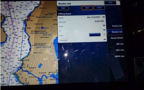

Hiding all routes worked, but I couldn't get just one to appear by selecting it from the route list. I couldn't find an option called "Engage". I tried "Edit", but that assumed I wanted to modify the route. The screenshot "Route List" is after selecting a particular route. 3 routes are visible. The selected one is from north to south from Edmonds to Shilshole. The other 2 are to Shilshole from the south and from the east. When I return to the main screen after selecting "Edit" on a particular route or just highlighting it, no routes are visible. The screenshot "Normal Display" is after returning to the main screen. Am I doing something wrong?
