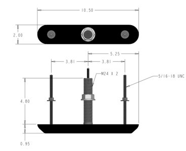

B buckshot Furuno Super Fan Dec 8, 2022 #1 225T-SS904 What is the max hull thickness the transducer is set up for? How long are the studs and stem? Thanks
Deep Blue Acoustics Sage Staff member Dec 8, 2022 #2 buckshot, Here is the dimensions for the 225T-SS904, and note that these measurements are in inches: - Deep Blue
