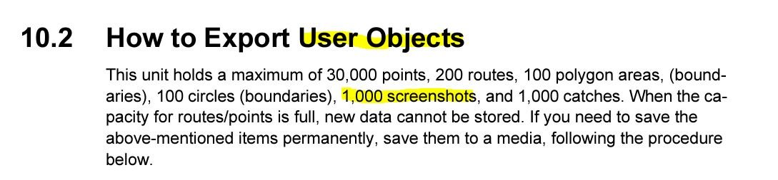

Screenshots not saved to memory stick but in internal memory are classified as "User Objects" and can be exported.CaptureFORUM.JPG
I had tried that but it doesn't do what I need. The problem is that the unit creates a single file with all the user objects in a proprietary .tzx format. I think all that I could do with it would be to import it to Time Zero software or to another TZT MFD.
I want to be able to dow what I used to do, which is save a .png screenshot file to a USB stick or SD card in the card reader.
If proper USB memory is inserted during the process of doing a screen capture, a PNG file is created like it always has done.
