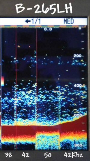

I don't have any head to head screen shots of a 585/B-260 vs. the 295/B-265. Below is a shot however of a 1150 using a 265 at different frequencies at 600ft+ that may help you.
