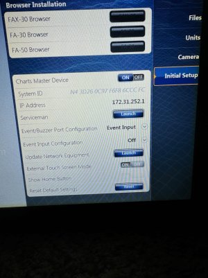

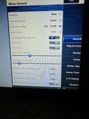

hi everyone. I just purchased a second hand TZT14 - it is in nice condition, but I can not find anywhere how to connect to a wifi or ethernet network. The GENERAL menu simply has no network items to select from

It is most likely a unit sold in a country where wifi wasn't certified and not installed or one that was owned by the government and disabled. If connected with other units, the other units can feed the weather information to this one but unfortunately this one will never be able to connect to wifi.
