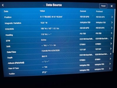

I missed that. I thought you said it still wasn't working. Glad it's working now. Heading is very important and should be within a degree or so of the Richie compass (or equivalent) and it should align with COG -for the most part- when moving 3kts or better. If it was off, the autopilot may have been fighting with the conflict.
