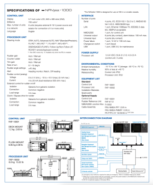

Could you please confirm whether the NAVpilot-711C (FAP-7011C control head + FAP-7002 processor) supports an analog rudder control output of −10 V to +10 V, similar to what is documented for the NAVpilot-1000? I attached a screenshot from the NAVpilot-1000 specs showing “Rudder control (analog): 0–5 V (min), −10 to +10 V (max) (5 mA max).”

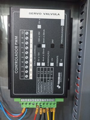

(screenshot from NAVpilot-1000 spec page, and the actual PWM controller that I'm using is attached)

- Workboat with hydraulic steering.
- The vessel’s proportional control is achieved by feeding a −10 V…+10 V command into a third-party PWM valve driver, which then modulates the hydraulic solenoid valves proportionally (greater helm amplitude = faster flow; smaller amplitude = slower flow).
What I can’t find in the 711C docs
- On the 711C I only see the SOL-A / SOL-B / COMMON connections to drive solenoids directly. If these are simple ON/OFF outputs, they would bypass my external PWM driver and could introduce “jerks” in the hydraulics rather than proportional control.
- Does the NAVpilot-711C provide a dedicated analog rudder command output (±10 V) comparable to the NAVpilot-1000? If yes, which terminals and what menu settings enable it?
- If the 711C does not natively output ±10 V, is there an official Furuno interface module (or recommended method) to convert the 711C’s steering command to ±10 V (or 4–20 mA) for a proportional valve controller? Part numbers would be greatly appreciated.
