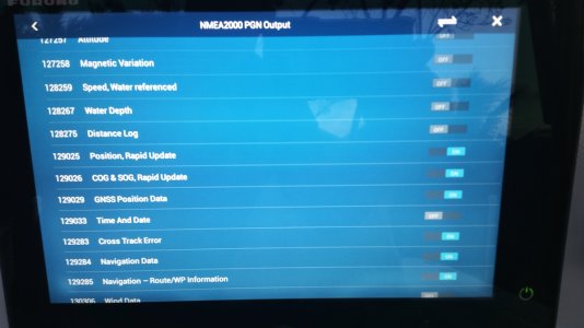

Took for sea trial today my new electronics. I got the pg 700 to calibrate and have 3 green lights. The autopilot will execute a 90 degree turn both ways, a 180 degree turn both ways
(Alert on both touch 2s stating turn in progress and progress shown on control head), and will keep the boat on course on a desired heading- no alarm as long as speed was set to manual..
In Sabiki mode, it alarms that there is no speed data
In any other mode it alarms there is no Nav data.
Chart master is 15" touch 2 and that shows up on pilot menu and pilot and pg 700 show up on the touch 2...
Reconnected NMEA from pilot and had same result
What did I miss..
Thank you for your time
