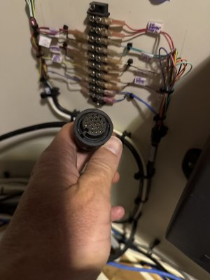

Have. 2008 Nn3d black box main with Navnet TZT 9 MFD, DRS radars, Simrad AP and Simrad RC42 Compass and Furuno FA 150 AIS. Changing to TZ Pro with NUC computers and removing the NN3D.

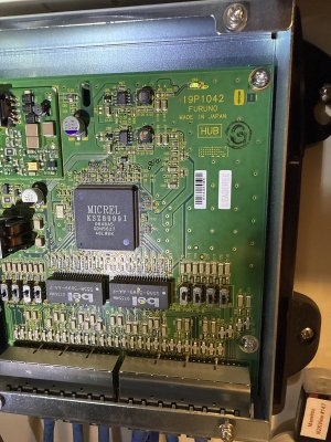

At install of TZ everything worked except Autopilot wouldn’t recognize data/route. When I shut down the NN3D - all of the sensors and radar are no longer on the TZor the TZT 9”. Data sources show NAvNet “connected but data unavailable”. Likewise, radar is not showing onTZ (connected to Ethernet hub1) or on the TZT9” and per TZ Furuno it is connected via Ethernet hub1 and has power to the DRS. Hub is showing data moving but nothing showing up in TZ or TZT9” mfd.
Have an Actisense NBX-1 NMEA to usb connected to the PC which is showing up on device list.
I feel like I am missing something that is stopping the data from flowing when the NN3D is off.
Any help is appreciated!
