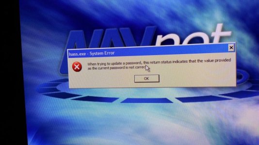

I got my MFDBB back today. The tech has giving it up and could not figure out the problem. He changed out the RAM as well as re-installed the software. He told me, he had no problem with re-installation software v2.11. When the unit rebooted from the update, it stuck at the NAVNET 3D blue screen forever, so he had to turned the unit off manually. Once the MFDBB rebooted manually, the NAVNET 3D screen displayed again and a warning window pop up displayed " WHEN TRYING TO UPDATE A PASSWORD, THIS RETURN STATUS INDICATES THAT THE VALUE PROVIDED AS THE CURRENT PASSWORD IS NOT CORRECT." Then it rebooted it self.
Could any one help me solve this problem? May be some tips could be great too.
