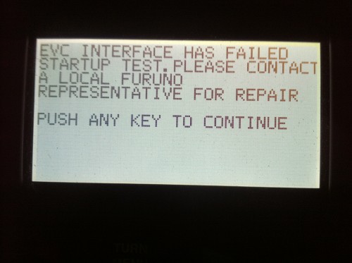

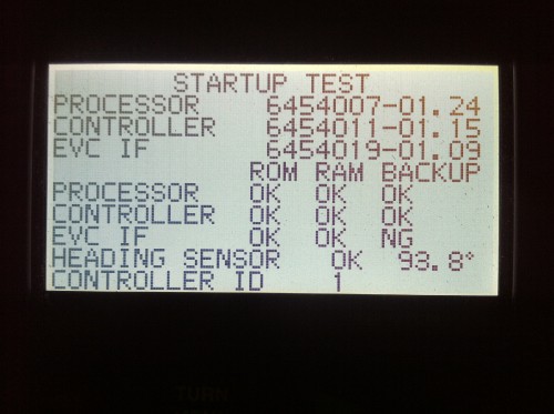

After Power On AP testing system and everything is OK except EVC Backup test("NG" is here)
and control panel give a message "EVC Startup test was failed".

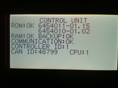

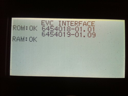

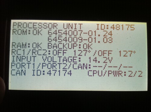

Diagnostic windows of processor unit, control unit and EVC interface is OK.

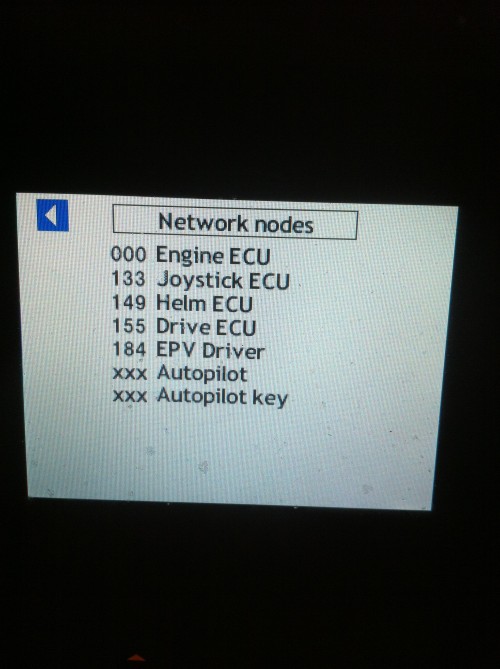

Also in Yanmar EVC network devices list Autopilot key and Autopilot have no network adresses.

I don't know a lot about the Yanmar but I know they require some sort of "key" be purchased to allow an autopilot to work. Do you have the Yanmar key on the NMEA 2000 bus?
Asking Japan about your question, it seem that this test is normal to fail if you use an older Furuno IF-NMEA2k2 converter. Even if upgraded to the newer software the converter does not have what is needed to show a good test. Although it say NG, they said the operations should work fine. For the test to pass, you would require an IF-NMEA2k2 that came from factory with 1.07 or newer software. Older units prior to this time will not pass the startup test even if upgraded but will function correctly otherwise. Hopefully that makes sense.
Yes, of course. Yanmar ID key was installed.
Converter came to us with 1.09 software, you can see on one of photos("EVC diagnostic") in post. That was approved on Garmin Chartplotter and Furuno MFD via NMEA2000, and via RS-232 interface of converter.
