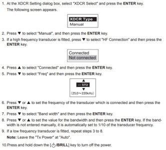

I tried to change the frequencies to the above #'s use page 19 of the Manuel frequency choice and control but could not.
Can I change them some other way ?
Also I was wondering if I can change them on display 2 will it affect all screens ? Would display 2 log and remember or do I change them every time I need those settings ?
Thanks
Ruddy,
If you follow these directions, you should be able to manually enter the frequencies of the B260 transducer:

Hi Deep Blue,
I can not find the XDCR dialogue box, I did not see it in the manual.
How do I get to it ?.
Thank you Ruddy.
