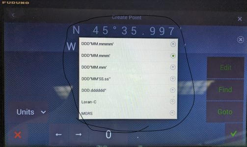

I have my Tzt2 set at DDD MM mmm. I have waypoints to enter that are in Degrees Minutes. They appear to be different. Can I input Degrees Minutes in as a waypoint when unit is set up in
DDD MM mmm?

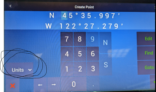

DDD MM mmm is Degree, minutes and portions of minutes. If you want to input under other formats someone provides it is pretty easy. You just touch "UNITS" prior to entry and choose the type you wish to input. Picking this during entry doesn't change the default you have chosen for the machine to display. You are just choosing the unit format for this one particular entry. 1678142000034.png
So what unit would you select for a position that looks like this 25.392241?
That is "decimal degrees". DDD.dddddd°
As long as the provider does not omit any characters you can typically match it up visually.
