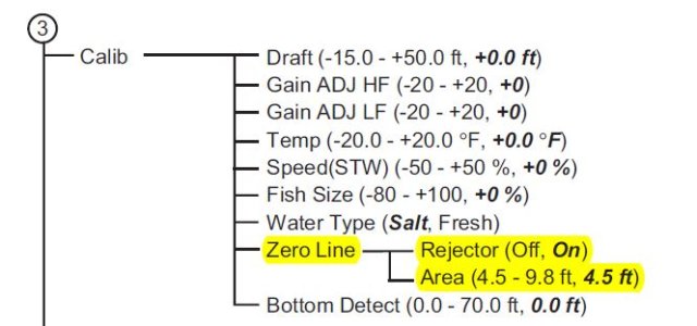

First turn off the BD mode in that shallow of water. Also know that using a TM series that most of the TX power is going down but actually some also goes up. My feeling is if you put your hand over the top of the transducer you will see that band change. Also there is a control called Zero Line that can be adjusted.
