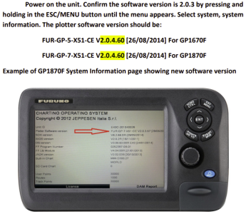

Thanks for the hint. Just checked and confirmed that I am running that software version. Checked the satellite screen and the unit is ‘seeing’ multiple satellites but they are all red in colour so I guess it’s not reading them. My handheld gps works fine in the same location….still stumped…
So, you have v2.0.4.60 software...that's good. Can you take a picture of the satellite screen, please? Also, if you have enough slack, can you move the display around to a different location to see if the satellites get a stronger signal? You can also try Menu-System-Internal GPS Setup and choose Restart GPS to see if that helps.
