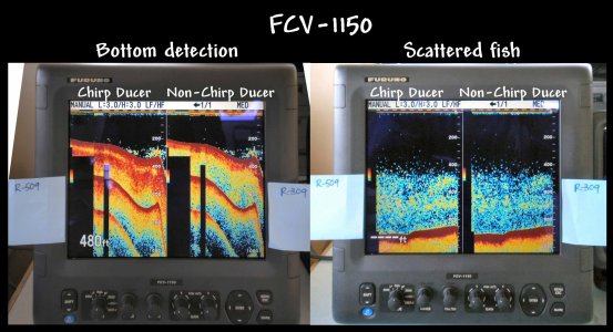

When I tested the two I found the performance very similar. In theory you can use a higher Tap setting on the lower end of the HF frequency range. However we have had a few cases where the Tap setting wasn't changed resulting in damage to the HF element. I see our Tap setting matrix also has a "C" Tap setting for the HF side so I will double check tomorrow on this.
Thanks very much for the reply Snips.
Looks like I have made a good decision to upgrade to the R509. I have trialled the HF of the 509 and it seems that I have to run much more gain to get the same performance as the 309. If you get any info on the tap settings I might be able to go back to Tap B with the 509, the same as I had it with the 309. I currently have it at Tap C.
