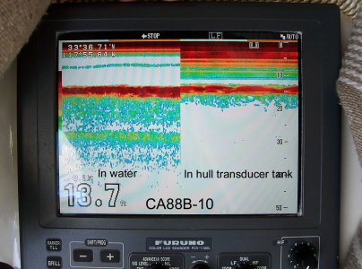

Since you haven't mounted the transducer yet you can do a nice comparison test. First, just hang the 1T over the side to see how many returns you see. Stop the sounders picture advance so the image is stationary. Now place the 1T in a bag of water. Restart the screen advance and hold the transducer over different locations on the hull. Hold the stem of the transducer so that the bag of water is contacting the hull but the face of the transducer is still parallel with the sea surface. During this test you want to see both 50 and 200Khz as the thickness of the hull will affect each frequency differently. Below is a screen shot of the test I did using a 88Khz transducer.

Ginodan,
For the record, I try to stay away of using in-hull transducers. I haven't seen one yet that has equal performance to a transducer that is wet faced. That is why I recommended doing the comparison test to see for yourself how much the signal loss there is.
