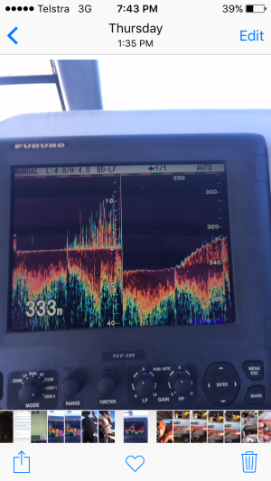

As for the TVG distance you suggest setting the depth at the same depth as I am fishing in? And set the TVG level at a low setting say about 3or4 or is it a case of experimenting while out there? this is a picture from my last trip out .Any comments appreciated
Regards Longrun

Good afternoon Longrun,
Thank you for sharing your photos.
Yes you could start to set the TVG distance to the same level you are fishing. If you desire to see more information in the water column you could always make the TVG distance less than your depth.
The photo looks pretty good, you are showing good bottom and good echos off the bottom. Although, there is not much information in the water column? Do you typically run a shift for the range?

Good morning Longrun,
Based on the Bottom Return in your last photo, it does appear that you may be experience some turbulence over the transducer. When you took that photo, what were the sea conditions and what were the vessel dynamics such as speed, where you going into chop ect. Also may i ask what size of vessel you are running and where the transducer mounting location is? As i mentioned in the previous post, we would really like to see more photos of the sounder. Please do not hesitate to crank the gain up, the water column information in the last photo was almost non-existent. Please turn the gain up until we can see some clutter. With that said, what pulse length are you running in the photo, what clutter curve and level are you running? What were the TVG levels in the photo.
You may also experiment with using the White Line, it may help you discriminate the bottom from targets directly off the bottom.
If you have an opportunity we would love to see some more photos with some information about your settings while the photo was taken.

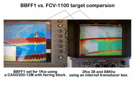

Longrun,
You can try increasing the gain but you still can't overcome the round trip power/signal loss of trying to shoot through the vessels hull. I have posted the below screen shot before of a wet faced vs in-hull performance. While these transducers are not the same as you are using you still can still see the affect. In the picture of the FCV-1100 you can see where I increased the gain to try to see the scatter fish but still it wasn't close as the using a wet faced transducer.

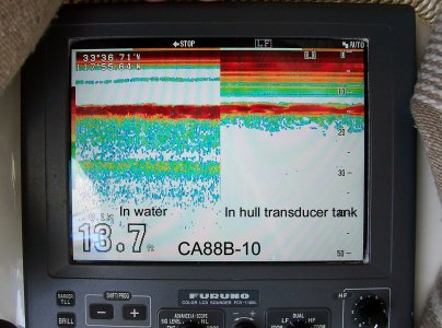

Longrun,
Here is a test I did at the dock with an 88Khz transducer. You can see how big the main bang is, this is a result of the TX pulse bouncing around inside the transducer housing. Also you don't see even a trace of the second echo which is an indication of how much signal is being attenuated.
