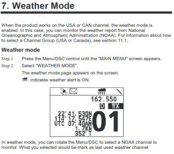

You followed the instructions below and in the menu between SCAN and FOG/HAILER/IC you do not see WEATHER MODE?
If you are in International or Canada mode you might try to switch to USA and see if that corrects it.

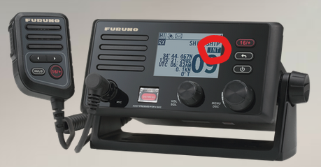

If you are in International channel group the weather mode will be disabled. International is the default settings. Pictured below is an easy way to tell how you are set.
MAIN MENU - CH FUNCTION SETUP - CH GROUP > Change this to USA
If that is not available, you may need a software update. V2.02 is the current version. There was an improvement made to the selection process.
MAIN MENU - GENERAL SETUP - SYSTEM INFO - SOFTWARE VERSION
