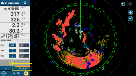

It sounds like the NavData window is getting closed sometimes. If you swipe in from the left towards the middle of the screen when on the radar screen and select the radar tab 1769812251037.png
It sounds like the NavData window is getting closed sometimes. If you swipe in from the left towards the middle of the screen when on the radar screen and select the radar tab View attachment 7016
I can access the gain, rain, and sea tuning functions consistently. I’m talking about the manual tuning slider that appears when you turn the auto tuning off located when you select [Furuno] >[Settings] >[Radar] located below Antenna height in the menu tree. With the system transmitting [TX] the option was there 1 day. The next time I looked for 2 days and it was gone. After I updated a couple charts it appeared again, and now it’s gone.
