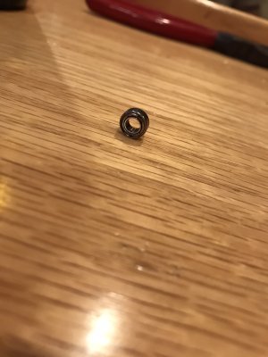

I just dismantled the Fi 5001, took me about an hour, next time it will five minutes. The design is good but if you dont know how they did it it is a kind of adventure.
As always, also this 500 USD gizmo fails becsus of a 25 Cent bearing

Just to say that I managed to get the bearings out of the Furuno Transducer FL5001 -and have ordered replacement bearings for the anemometer/transducer side that were about $15ea from RS-online, and will happily help anyone who wants to do same rather than spend >$500 on a new unit....
thanks Simon
simon@oceanafricasafari.com
So after you've removed the tiny star screw from both the top and the bottom of the vane/transducer unit, the wind vane and wind paddle/anemometer can be eased gently off.. The WHOLE anemometer side - the larger more bulbous side - then screws off and you can see the small green PBC inside - don't touch this!
The other side has a thin shaft that holds the wind paddles - it has a thin pin through it @ 90deg...
Below this is a plastic cylindrical housing about 9/10mm in diameter that has been PRESSED in - you need to gently and carefully lever this out.
Once this is out, carefully take off the 2 x O-rings that hold the 2 halves of the cylinder together - one these are off the plastic cylinder splits down the middle and the bearings on the shaft are exposed.
Again, gently, - ease the bearings off the shaft - good idea to take a pic of what it looks like and where the locking clip and spacers are located.
Then with new bearings in hand - mirror the process above - I am still waiting for the new bearings to arrive here in Cape Town....
But so far, better and much more fun than a $500 new unit....
cheers Simon
BTW - few folks have contacted me for bearing specs - so here's the link to the RS page where I ordered them.
hope this helps - feel free to contact me if help needed - details in thread above - cheers - Simon

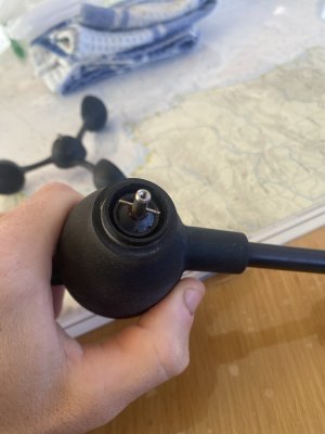

Hi everyone, have a problem with my anemometer not working due to wear and rust.
I want to know what part am I meant to take out, seem to be making no progress.
Also, what tool should I use?
Much Appreciated
