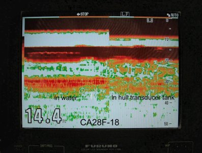

Thinking of FCV 587 & CA-50/200 1T setup. The Japanese website shows CA-50/200 1T setup install in a oil tank, like a M260 setup. Question is how can/will Acc- fish & bottom discrimination work in a in tank setup? Else how can u mount the CA-50/200 1T in a wet face setup???? The furuno website stated CA-50/200 1T provide both Accu-Fish & bottom discrimination!!! I've another option of using TM260, but I fish in 10ft to 330ft waters, basically spend most fishing in 10ft to 250ft, I need/like the wide cone coverage of CA-50/200 1T at 28degree vs TM260's. 19degree!!!!
Any thoughts? Anyone with perform new comparison of real life sonar image of above both setup? And also CA-50/200 1T in hull tank mount with ability to have Accu-fish & Bottom Discrimination works???
