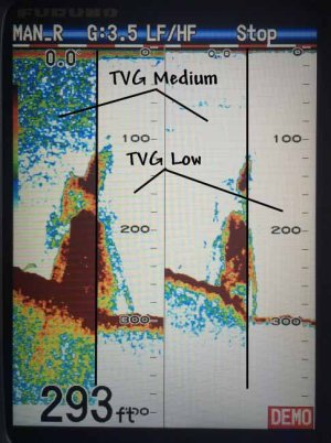

Foudy15,
TVG stands for Time Varied Gain. It is used to control a sounders shallow water gain i.e you don't as much at 10ft as you do at 300ft. Normally the TVG curve is set on Medium when you changed it to Low you have less gain so less targets/clutter. As you can see in the below screen shot below changing from Medium to Low has a more visual effect on the 50Khz side than the 200Khz. Using the sounders Demo mode is a good way to see the effect when you change settings.
Also just know that your noise issue is still there, you just need to raise your gain level to see it.

I know the noise is still there but when I put the TVG to low I can increase the gain to 4 without having noise all over the screen whereas when it's medium the maximum gain I can have is between 1 and 2.
