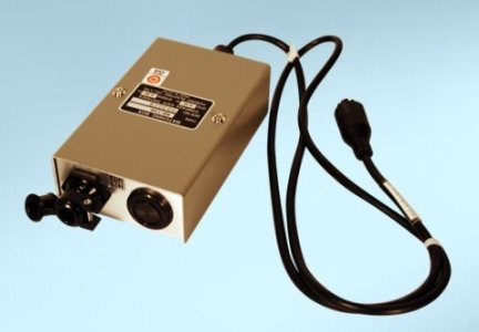

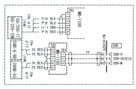

The CA50/200-12M is one of my favorite Non-Diplexed Transducers, and you'll need to utilize it with a MB-1100 Matching Box if you want to connect this transducer to any Diplexed Fish finders like the FCV-588, GP1971F or any TZTouch2/TZTouch3 MFDs.
View attachment 6525View attachment 6526

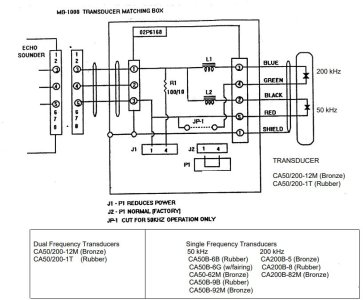

is the same diagram for the mb1000? i have to connect ca 50/200 to tzt3, and i got the mb1000 (which has a 10pin, and then and adaptor to a 12 pin for the tzt3)
mikidelnord,
The wiring for the MB-1000 differs slightly from the newer MB-1100. Here is the wiring connection diagram for the MB-1000:

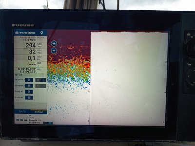

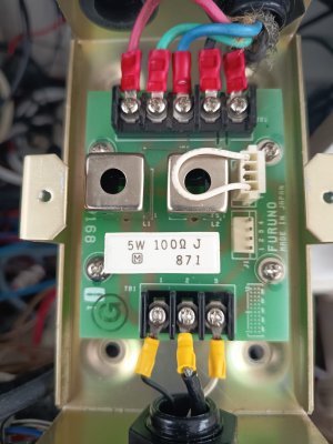

Hi, today I went to the boat and tested the connections. I can only see the low frequency, as shown in the photo (the transducer works because with the Furuno VX2 both frequencies were visible). It only appears if I select a 265LH-type transducer; if I choose, for example, 50/200, nothing shows up. So I’m not sure if I’m doing something wrong. I’m attaching a photo of the MB1000 connections to see if anything is incorrect.”

mikidelnord,
Re-check your wiring. It should be Blue & Green for the 200kHz side, and then Black & Red for the 50kHz side. Then go into the TZT2's menu and select the "50/200-1T" for the transducer.
