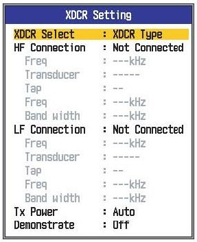

Can you please help with turning on - and off the simulator mode on an fcv-295

Eric, read your manual ( I think its in the installation manual). Hold down the menu key while you power the unit on. The setup mode screen will appear. Choose the option at the bottom of the screen to simulate....

Eric,
Dougie is correct, the demo mode can be found at the bottom of the Transducer set up menu.

Hi Snips and Dougie
Thanks for your replies. I have now found out how to use DEMO and I have also managed to connect the Lowrance. Seems like it does need all 4 wires to be connected
