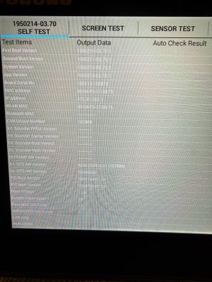

I rolled back to 3.80 and then 3.70.1, still both have the alarm. Both times, I noticed errors during the update that said sounder update failed and sounder FPGA update failed. It was last year when I did the OTA update, and I wasn't watching the screen, so I could have gotten the same errors then.
Same thing as this guy, https://furunousaforum.com/threads/internal-sounder-main-update-failed.21572/. I ran a test and the sounder info is all blank.
