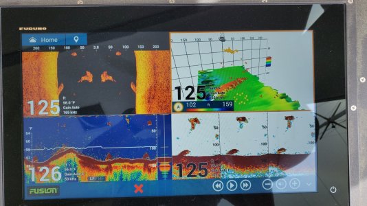

If they would allow the bathymetry data to be synced to the cloud with everything else this would be possible. Though still expensive. Also keep in mind that the DFF3D doesn’t function well below 12ft of water depth.

I think that Hummingbird has the market cornered with their shallow water sounders. I agree, I would love to see Furuno produce something to compete with their helix/solix lineup. I honestly don't believe that it is really in the cards given most of Furuno's Target audience in the recreation world in offshore fishing. That being said, there is a sunken submarine that is in 125' of water here in the patuxent that I can see clear as day as a small hill in on the bottom. While I can't really make it out to be a submarine if I didn't know what it was, I can make out all the fish that are holding around that structure. A local guy went over it with his Solix system, clearly identified it as a submarine but didn't show a single fish being around the structure. Personally I want to see the presence of the fish.

I want furunos sidescan on my trawler but if it doesn’t work well at shallower depths and doesn’t go further forward in its beam it isn’t ideally suited for my need of poking into skinny water inlets and looking for rocks etc that tidal changes will reveal.
