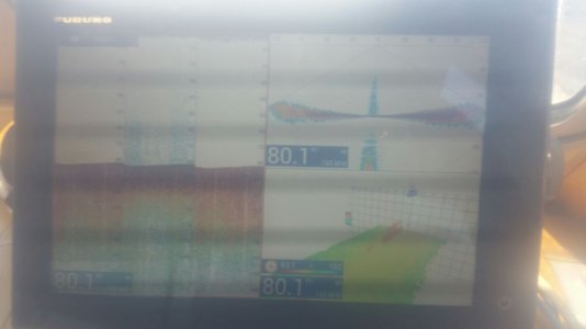

I am trying to setup my dff3d for bottom fishinhg at about 60-100 meters but i have some issues. As you can see at attached photo middle row is always giving some signal and making confusion to me.In this way my crossection and history mode is unusable.This is happening only when i get to deeper waters. Until app. 25 meters everything is clear in middle part as well.
Could somebody try to explain which parameters to play with in order to have correct feedback from sonar?

Anthony,
What you are seeing in noise getting into the system. Noise appears differently on a multibeam sounder then a traditional one. Check to make sure that the DFF3D module is grounded and then also recheck that the shield on the transducer cable is properly grounded in the cable clamp.

Anthony,
The noise is still there, but the DFF3D's TVG curve is such it doesn't appear. You can tying the ground and negative together to see if that helps.
Good morning Anthony,
Thank you for your inquiry, I can assure you the “torch beam” that you see is caused by noise from something on the electrical side. The photo that you provided is a little blurry so I could not quite see the rest of the triple beam screen so you could have turbulence issues as well.

I agree with C-bass. I have saw many cases like this always resolved by ensuring the transducer shield (all of them) are firmly grounded under the grounding clamp as the transducer cable enters the unit, or by finding the source of electrical noise on the boat.

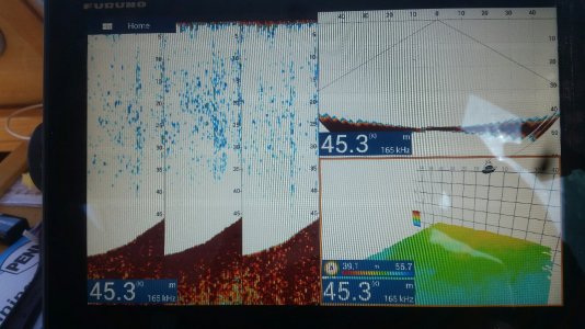

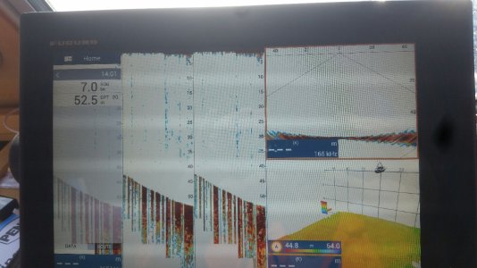

Thank you guys for help....i did ground system properly (to the rudder) and there is no more "torch beam" noise.
However i still some issues:
1. When depth is changing fast depth reading is geting lost (is there some setting i could play with to prevent this?)check attached photo
2. Could you tell from other attached photo is there more noise from turbulence?

Anthony,
By the looks of the bottom gaps in your second screen shot you are getting turbulence over the face of the transducer. Just know they are no settings that can prevent these gaps from appearing. Down the road you will learn what vessel speed and water conditions will give you the most stable bottom reading. Besides the gaps in the bottom, turbulence will take away any fish targets there may be in the water column.
