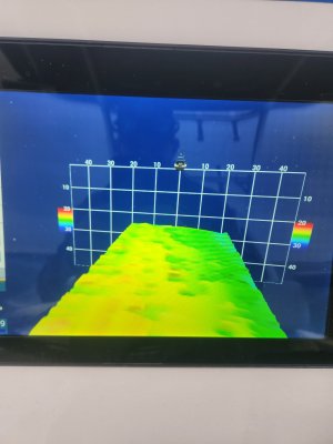

I feel like my dff3d transducer is always falling off to the starboard side. Does anybody know why this could be happening and what to do to correct this?
If the transducer isn't perfectly level and you are using the internal motion sensor, you can apply a "Roll Sensor Offset" to correct it. This is found in the motion sensor menu. Operators Manual page 3-7 (digital page 33).
If using a satellite compass, the offset would be applied to the compass itself.
