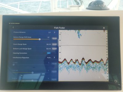

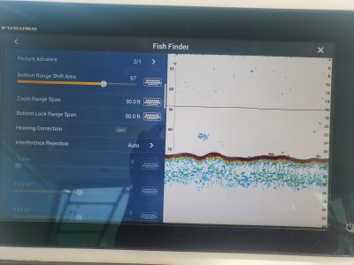

I have a DFF3 hooked up to TZT2 with R109LH transducer and have a SCX-20 sat compass. I had an issue with my DFF3 and when I got it hooked back up I must have some setting issue or something. If I turn on the heaving correction the screen is very choppy and seems to be much worse than when I turn off the heaving correction. I am on flat bottom but the waves were a tight 2 - 3 ft. +/-
Sonar Heave off =
Sonar Heave on =

I am still having this issue. When I turn on the Heaving control under the fish finder settings. The depth changes about 1.5 ft. and the display looks like it is very choppy even though I am tied up in a slip in the marina. Could it be an issue with the DFF3? The problem started when I changed the DFF3 out due to the old one failing. After installing the new one I now have this issue but it seems like a setup problem.
