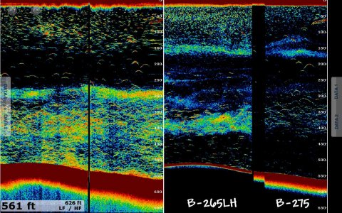

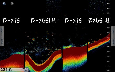

For me it is going to come down to how much time do you spend out in 500ft vs 100ft. From testing I think that the wide HF side of the 275 is good for fish detection to 200ft+. Below are a couple of screen shots from testing the HF side between the two transducers.

Snips,
Thanks for the insight & the screen shots.
I plan on spending most of my fishing time in 200-400' FOW so I can see the benefits of the B-265LH over the B-275 within that range..
