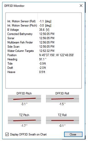

Yes It does react, it shows the rolling declination
, I think with a small lag , but it could be software related which show it a bit later

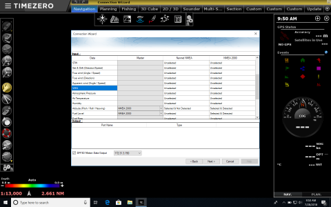

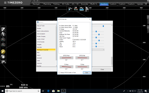

I was again yesterday offshore with my Boat. Unfortunately I didn't manage to find what the problem is. I still got the Rolling effect. On my monitor page the Internat motion sensor is reacting , but I don't know why is not integrating to the cross section.
One thing I noticed, is that , on the connection manager settings, the option for the Roll & Pitch is detected only for NMEA 2000 but for the Navnet NMEA ( DFF3D) is set to selected & undetected.
Here are some photos
