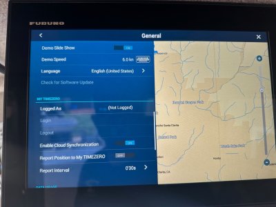

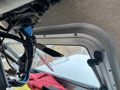

Hello, I have not connected my TZT2 or TZT3 to the internet ever for any updates. Yesterday I connected to my house wifi for the first time on both units. Both showed they were connected. But when I went to look for un update, I did not see one. Also, what is My Timezero? My goal is to update my mapping, the free ones for now.

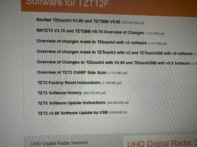

TZT2 won't do Internet updates, but you can get the update and instructions here (assuming not a TZT2BB): https://furunousa.com/en/support/TZTL12F
TZT3 needs to have v3 or higher to allow Internet updates. You can also perform update via these instructions and software here: https://furunousa.com/en/support/TZT12F

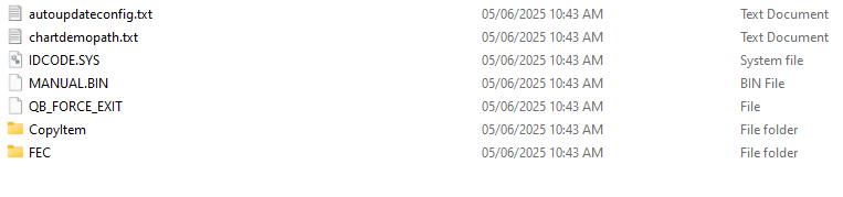

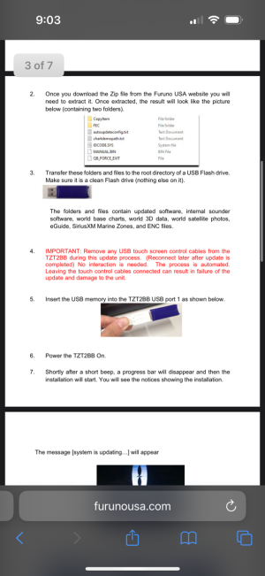

Thanks for the help. Yesterday I downloaded all the free charts for my area, downloaded the zip files to a 32g usb drive and plugged them into the back of the units and nothing would show up. I tried my tzt2 and tzt3. Do I need to extract the zip file onto my computer and then put the file on the usb and then into the unit? I downloaded the chart, a zip file, onto my pc computer, then I cut and pasted the zip onto the usb drive, inserted the usb into the back, turned on the units and both acted like normal, not registering the usb is in them.
Charts must be placed on the Micro SD card that is in the back of the unit. You would unzip the files on a PC and then transfer them to the Micro SD card
