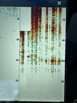

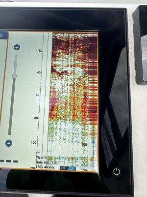

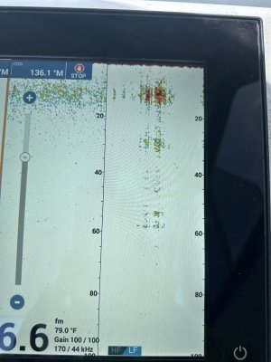

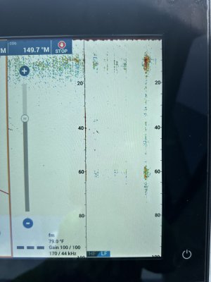

What would be causing this on my low frequency?
It seems like the transducer is skipping on and off cause there will be blank spaces and all of a sudden a lot of noise when the high frequency does not show the same picture.

It looks less like noise and more like cavitation IMHO.

JasonM,
What you are seeing is a classic case of turbulence that is happening to the fishfinder's transducer. When it comes to turbulence, it will affect the Low Frequency side before affecting the High Frequency side.
How is the transducer mounted on your vessel and what is the vessel's speed when this begins to happen..?

Hi Deep Blue,
The transducer is pocket mounted at the keel of the boat. That was the boat just sitting still under no power and drifting. We drop 5lb leads here with chum below the boat 50-100 fathoms deep and sometimes we won’t see them on our finder. I had a 1kw transducer before that was able to pick them up but this 3kw is not as consistent and not able to mark fish clearly.
