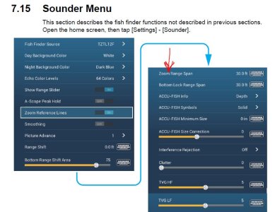

That is excellent news. That means you did a great job fitting the transducer into the fairing block. That's where it all starts, well done. Now I don't know if I fully understand the question but I think you want to adjust the zoom range of the left side of the screen. To do that you will need to go into the sounder set up menu. The default setting is 30ft, but you can adjust it via the menu. See below.

Snips,Yes I understand the zoom range.Can I run no zoom regular screen and shift the range to see the last 15 ft ,full screen?I fish from 50 to 150ft for bottom fish.Would like to have full screen of last 15-20.Is there a way to set your shift range and then move the bottom up or down as depth changes with the slider bar??What should I set my shift range at?What kind of settings do you recommend. Tx,Rx,smoothing.Thanks Capt.Mike
Capt. Mike,
On the main screen just do a upward swipe to change the viewing point (start) of the sounder range. Normally is starts at 0, but if you swipe upward you can move it down wherever you want. The minimum scale is 16ft however i.e. if you start the top at 20ft the bottom will be 36ft. You can have it larger but not smaller.

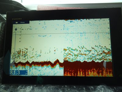

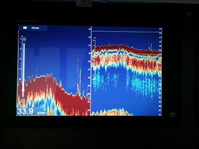

Can you take a couple of screen shots next time out for me. I would like to see both frequencies if you have a chance. Also your menus settings. Basically on the TZT2 I adjust Range, Gain and Clutter. I leave the screen advance on 1/1, TX rate at 20 and Power at 10. The screen shot below was from a test in Alaska on a pretty rough day with the transducer hanging over the side, I switched from HF to LF mid screen.

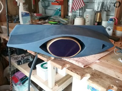

Sure I have trips next week.I would like to post pics of the transducer install.Can't seem to get them up.What us the proper way to post pics? They are jpg on a tablet? thanks
[attachment=0]20170121_173239.jpg[/attachment]I can only add one photo at a time.Came out awesome.Shows bottom nice at speed. A few more screen adjustments and I think it will be great.

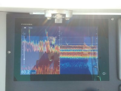

20170212_100929-1944x1458.jpg20170212_085117-1944x1458.jpg20170212_070039-1944x1458.jpgI was traveling 30 miles per hour in this shot(33 ft).Second and third shot we caught keeper grouper.The only adjustment is gain at 50-55.What do you think of the images.Adjustments??
Capt. Mike,
Thanks for posting the screen shots, they look pretty darn nice.
What is the bottom type you are fishing over?
Snips,You have to be on hard bottom to catch keeper grouper.We caught 10 keepers on the two images.Customers were happy.thanks Capt.Mike

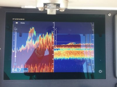

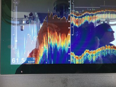

20170214_143656-1944x1458.jpgSnips,Was coming home yesterday at 30mph,when I noticed the double echo..bottom right..dark red.What I thought was strange was there was no red under
the first echo.Should I be looking at the second echo?I didn't turn around and look at it.Mike
Capt. Mike.
It would be interesting to take a core sample of the bottom type you like to fish over. To me it appears comprised of three layers. In your screen shot it appears that twice the third layer showed a density change which was displayed in the primary and secondary returns. The other return you are asking about I think is more of a density change in the very top layer. I trust you marked the spot so next time you are in the area you can take another look at it. This time I would use both frequencies, personally I prefer to use the LF side for density changes rather the HF side. Using both you see and compare the two.
