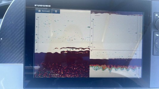

Hello Folks,
I recently bought a B175m to connect on the TZT3.
It came with 8-10 pin adapter.
Yet I used the 8 pin cable directly to connect to 12 pin MFD.
I can’t see the temperature on my TZT12F.
Can someone share the right mapping or should I switch to 10-12 connection?
Everything else looks okay.
I am guessing you have an Airmar mix and match transducer? If they provide you the mix/match adaptor to Furuno 10pin, you would then just add the provided 10 to 12 pin adaptor that came with your TZT3; to connect that to the 12 pin internal sounder. I am confused how you got the 8 pin currently connected.
