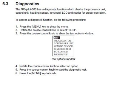

Couple things, the linear rudder reference unit in the past has had issues with corrosion. When an autopilot stops working that is using a linear rudder reference unit that is often times the source of trouble. There are a couple of things to do. First take good photos of the Linear RRU Installation on the engines, take good photos of the inside of the NavPilot Processor where all the wires are terminated and post them to this forum so we can look at what you are dealing with at all points. I have no doubt the the authorized dealer did a good job with the installation, I just want to verify what we are working with. Next we need to get an idea of what version of software the NavPilot 500 O/B is using. Please follow the steps below and report back what version of software. We also need to verify what Linear RRU is installed. It is probably a Teleflex RRU but we need to know the model number, please report back with that information.
