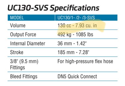

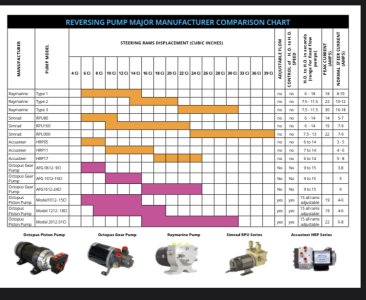

I can't say if that steering cyl is large enough for the engines and defer to the engine or cylinder company. Normally I check if the pump size is proper for the cylinder volume. Looking up the UC130-SVS-1 online it seems no one really says how many cubic inches it is. You running just one of these? Do you know the cubes?

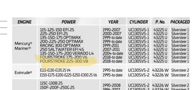

To clarify, The motor is not the verado steering (AMS) model. It is CMS, manual steering.
UFLEX brochure says its just under 8 CI. And it supports the Merc 300 V8. It looks like they will work but Im wondering if I’m missing something.

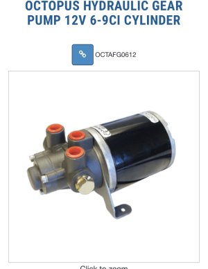

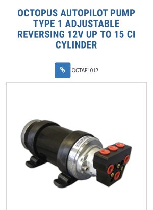

Is either pump preferred for this application? The piston pump is adjustable but the gear pump is not. Thanks again for your input.

So the gear pump is listed, that’s good. Still wondering about the piston pump, Model 1012-15CI
The Octopus PUMPOCT10-12 pumps are going to be the least headache for a Furuno AP, IMHO and they're pretty quiet.
