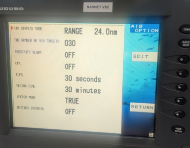

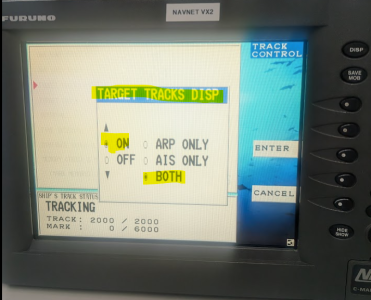

After an accidental reset of the vx2, AIS-target does not show - while all other is good (plotter, sounder, gps, radar, autopilot working as before).
I am almost sure its not a “digital setup issue”, as it has happened once before (Ais-data suddenly showed up again as some setting was changed…have long forgotten what I did to make it show up). I suspect it is some kind of ordinary user setting, that blocks the display of Ais-data.
How to display ais-data? Can anyone provide a tip, that does *not* relate to port and nmea-settings, but has to do with some ordinary user setting - or combination of user settings...
Thank you.
Ps - all software are latest. The FA50 does send data just fine, when tjecked on Marine Traffic.
Thank you.
