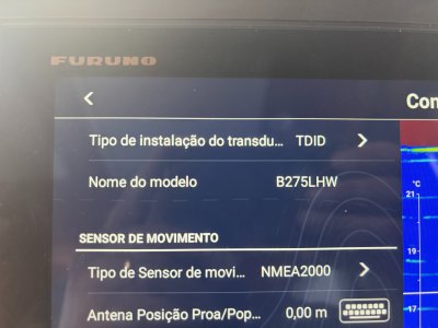

Yes, I only have one TZT 16x and in the transducer configuration menu the model that appears is the correct one B275LHW

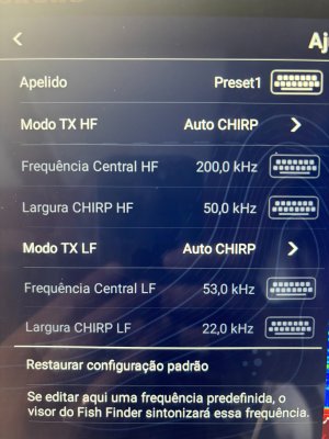

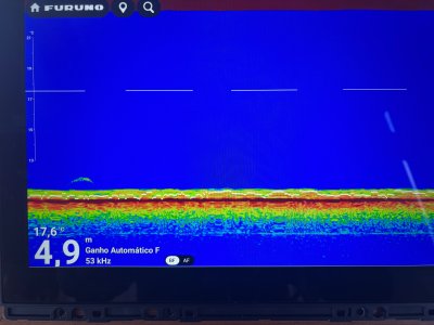

The frequencies remain as pictured LF - 53 KHz / HF - 200 KHz

Use the TZTXFF as source for depth. The frequencies listed "LF- 53 KHz / HF - 200 KHz" are fine...it is chirping with the B275LHW.
