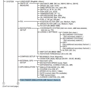

Welcome back. It sounds like you have a couple of issues going on, first of which is the sounders performance when you at speed. The key here is trying to get smooth water flow over the face of the transducer. This can be very difficult with a transom transducer specially at higher speeds. Unfortunately there are very few settings (sounder wise) that help in turbulent waters. Without see how your transducer is mounted my only suggestions would be to use 200Khz, manual range and a manual TX Rate of 20 when running. As far as working with the sounder menu's may I suggest grabbing a cup of coffee using it at the dock in the demo mode. This will give you an opportunity to go through menu's and settings in a calm environment. The 1870 is a great sounder and will serve you well. If you should have any additional questions please let us know.

Ok took your advise and a copy of the INSTRUCTIONS ;) spent and hour or so with that.
The big one was turning off the bottom discrimination to get back the manual control.
Looks pretty good in the marina at 12 feet of water. The other big revelation was that the manual depth control is set to RANGES not necessarily some thing I can adjust on the fly.
I reset a couple of the ranges that I know I will use most (200 feet for tuna).
